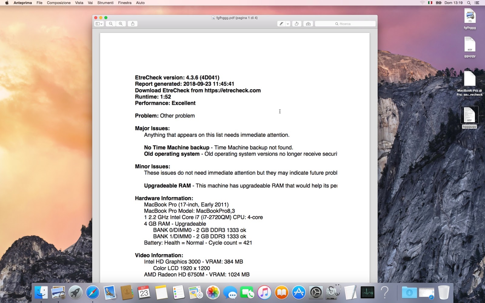

Questo è il test EtreCheck appena fatto
EtreCheck version: 4.3.6 (4D041)
Report generated: 2018-09-23 11:45:41 Download EtreCheck Runtime: 1:52
Performance: Excellent
Problem: Other problem Major Issues:
Anything that appears on this list needs immediate attention. No Time Machine backup - Time Machine backup not found.
Old operating system - Old operating system versions no longer receive securit Minor Issues:
These issues do not need immediate attention but they may indicate future probl
Upgradeable RAM - This machine has upgradeable RAM that would help its per
Hardware Information:
MacBook Pro (17-inch, Early 2011)
MacBook Pro Model: MacBookPro8,3
1 2.2 GHz Intel Core i7 (i7-2720QM) CPU: 4-core 4 GB RAM - Upgradeable
BANK 0/DIMM0 - 2 GB DDR3 1333 ok
BANK 1/DIMM0 - 2 GB DDR3 1333 ok Battery: Health = Normal - Cycle count = 421
Video Information:
Intel HD Graphics 3000 - VRAM: 384 MB Color LCD 1920 x 1200
AMD Radeon HD 6750M - VRAM: 1024 MB
Drives:
disk0 - Samsung SSD 750 EVO 250GB 250.06 GB (Solid State - TRIM: No) Internal SATA 6 Gigabit Serial ATA
disk0s1 - EFI [EFI] 210 MB
disk0s2 - S*******L [Core Storage Container] 249.20 GB
disk1 - S*******L (Journaled HFS+) 248.83 GB disk0s3 - Recovery HD [Recovery] 650 MB
disk2 - WD Elements 107C Media 4.00 TB External USB
disk2s1 - EFI [EFI] 315 MB disk2s2 - h**d (ExFAT) 4.00 TB
disk3 - HTS54108 0G9AT00 Media 80.03 GB
External USB
disk3s1 - EFI [EFI] 210 MB
disk3s2 - 8**************l (Journaled HFS+) 79.68 GB
Mounted Volumes:
disk1 - S*******L 248.83 GB (236.49 GB free) Journaled HFS+
Mount point: /
disk2s2 - h**d 4.00 TB (804.73 GB free) ExFAT
Mount point: /Volumes/h**d
disk3s2 - 8**************l 79.68 GB (79.47 GB free) Journaled HFS+
Mount point: /Volumes/8**************l
Network:
Interface Bluetooth-Modem: Bluetooth DUN Interface en0: Ethernet
One IPv4 address Interface fw0: FireWire Interface en1: Wi-Fi
802.11 a/b/g/n
Interface en3: Bluetooth PAN Interface bridge0: Thunderbolt Bridge
System Software:
OS X Yosemite 10.10.5 (14F27)
Time since boot: Less than an hour
System Load: 1.30 (1 min ago) 1.33 (5 min ago) 1.16 (15 min ago)
Security:
System Status
Gatekeeper Mac App Store and identified developers
System Launch Agents:
[Not Loaded] [Loaded] [Running]
4 Apple tasks 148 Apple tasks 59 Apple tasks
System Launch Daemons:
45 Apple tasks 138 Apple tasks 78 Apple tasks
Internet Plug-ins:
Default Browser: (installed 2015-07-17) QuickTime Plugin: (installed 2018-09-23)
Time Machine:
Time Machine Not Configured!
Top Processes by CPU:
Process (count)
mdworker (9) mds mds_stores WindowServer kernel_task
Source
Apple Apple Apple Apple Apple
% of CPU
26 7 6 6 4
RAM usage
576 MB 454 MB 218 MB 166 MB 155 MB
Energy (0-100)
8 3 3 2 1
Top Processes by Memory:
Process (count)
mdworker (9) kernel_task Finder
Safari mds_stores
Source
Location
Top Processes by Energy Use:
Process (count)
mdworker (9) mds WindowServer mds_stores Finder
Source
Location
Virtual Memory Information:
Available RAM Free RAM
Used RAM
Cached files Swap Used
916 MB 41 MB
3.11 GB
875 MB 0 B
Location
End of report

utente_autoeliminato
Iscritto il: mar, 27 feb 2018 05:36
Messaggi: 1273
Diciamo che installando da zero hai escluso il problema software.
Prima di dire che è hardware - se non lo hai già fatto - dovresti fare il reset PRAM/NVRAM e il reset SMC, vedrai si occupano anche della retroilluminazione
https://support.apple.com/it-it/HT204063
https://support.apple.com/it-it/HT201295
Quest'utente è stato eliminato su sua richiesta. Le tracce dei messaggi scritti restano ai fini storici. [admin]
